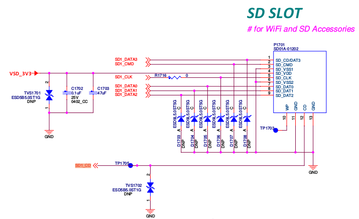

I and my customer have tested SD/MMC manufacture mode and has an issue which is hard to understand.
[Our test condition]
Board: MCIMX6ULL-EVK, MCIMX6UL-EVK
MFGTool: L4.9.11_1.0.0
Host PC: Windos10 and 7
[Test flow]
1. Connect the micro-B end of the supplied USB cable into USB OTG port J1102
2. Set SW602 to ON, OFF (from 1-2 bit) to enter internal boot mode
3. Set SW601 to OFF, OFF, ON, OFF (from 1-4 bit) to boot from the microSD which is on CPU module.
4. Detach microSD card
5. Insert SD card adapter with micro SD card to SD connector which is on Base board
6. Power on a EVK
7. It can't detect the board with MFGTool.
[Test result]
(a)Insert full size SD card:                               Can't detect board by MFGTool
(b)Insert full size SD adopter with microSD:     Can't detect board by MFGTool
(c)Insert full size SD adopter without microSD: Can detect board by MFGTool
(d)Without SD full size adopter and microSD:   Can detect board by MFGTool
According to the (a) and (d) of test result, I understand that SD1_CD is used to detect whether a card is inserted or not.
On the other hand, I can't understand the difference of (b) and (c).
Furthermore, I measured a SD1_CD by TP1705 in MCIMX6ULL-EVK and got same signal level from both case.

It is the ROM behaviour when SD card is connected it will not go into Serial Downloader Mode.
No, the behaviour is different for (b) and (c) case. As in (b) case, it will detect the signal level of SD1_CD while in (c) case it will not detect the SD1_CD signal as microSD is not there in Adapter.

Que: Is there a related to SD port? In another word, is it same behavior if a  user makes a board which an SD1 for first boot and SD2 for secondary boot?
Ans: Yes, there will be the same behavior for the boards which will be designed using this SoC i.MX6UL/6ULL. As this is a behavior of SoC i.MX6UL/6ULL, it will remain the same across all boards which use this SoC.
Que: As I mentioned before, the signal level of SD1_CD for (b) and (c) are same signal level when I measured by an  oscilloscope. What is a criteria of detect ?
Does it detect by voltage level?
Ans: SD1_CD is used to detect whether the card is inserted
In (b) case, it will detect the SD1_CD signal because you are inserting a  full-size SD adapter with microSD.
In (c) case, it will not detect the SD1_CD signal because you are inserting a full-size SD adapter without microSD.

Sorry, I can't understand the meaning of "detect whether the card is inserted”.
Does the card and CPU are communicate something when user are inserting the SD ?
In my understanding, the detection is by voltage level of SD1_CD signal.
Am I wrong ?
Ko-hey
2,725件の閲覧回数
shivanipatel
Senior Contributor II
Hi ko-hey‌,
In i.MX6UL EVK board, SD card socket has a CD pin/SD1_CD signal as you can see in below snapshot of i.MX 6UL evk schematic.
This CD pin/SD1_CD signal will get connected to the GND pin while inserting the adapter without micro SD card or adapter with micro SD card, therefore you are getting the same signal level for (b) and (c) cases. And it will be in the HIGH state when no any insertion of the adapter or adapter with a  card.
