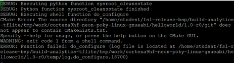

We have a c++ code and CMakeLists.txt on Github which needs to be run with Cmake. However, when we try to bitbake our recipe we get this specific CMake error;
-Please check below for our recipe and txt. files-

Can you provide the log.do_configure??
14,149 Views
ardtrkc
log.do_configure is below.
DEBUG: Executing python function sysroot_cleansstate
DEBUG: Python function sysroot_cleansstate finished
DEBUG: Executing shell function do_configure
CMake Error: The source directory "/home/student/fsl-release-bsp/build-analytics-tflite/tmp/work/cortexa9hf-neon-poky-linux-gnueabi/helloworld/1.0-r0/git" does not appear to contain CMakeLists.txt.
Specify --help for usage, or press the help button on the CMake GUI.
WARNING: exit code 1 from a shell command.
ERROR: Function failed: do_configure (log file is located at /home/student/fsl-release-bsp/build-analytics-tflite/tmp/work/cortexa9hf-neon-poky-linux-gnueabi/helloworld/1.0-r0/temp/log.do_configure.28784)
