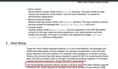

The i.MX Yocto Project User's Guide  has recommended minimum Ubuntu version.Please check the i.MX Yocto Project User's Guide you refering and install all packages refering the 3.2 Host packages.

You can try Ubuntu16.04, these error are caused by Ubuntu version of Host PC
