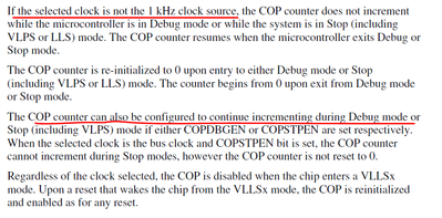

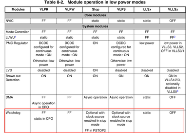

In MKW36A512RM, watchdog does not work in LLSx & VLLSx.
There are 8 DeepSleep mode in PWR_Configuration.h, looks like the watchdog only works in mode 6(MCU in STOP), But Mode 6 has a higher power consumption. Can I use watchdog in low power mode?
1,080 Views
nxf56274
The code do not realize. You have to add code by yourself. Actually, I am not sure if it is good to add watchdog into the low power mode.

nxf56274
If you choose 1khz source clock for watchdog, you can use watchdog in vlps mode.
