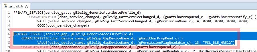

Sebastian_Del_Rio
Hi Marco, I hope you're doing well!
There is a characteristic in the gatt_db.h header file of the BLE examples called char_device_name with a value of "value_device_name". The number before the name itself corresponds to the length of your device name string. Could you please try changing the name through here?
Please let me know if you continue to have issues.
