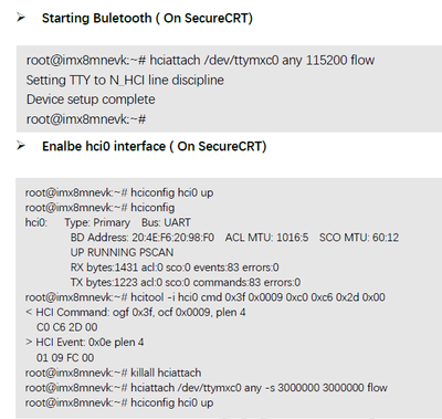

Without this parameter, should also be successful to change. Need to remind you that, please firstly set it to 115200 after loading driver, then change it to 3M bps.
We have tested it on i.mx 8MNano built-in 88W8987 chip.
Below is our test screenshot:
Please have a try and let us know the result, thanks.
