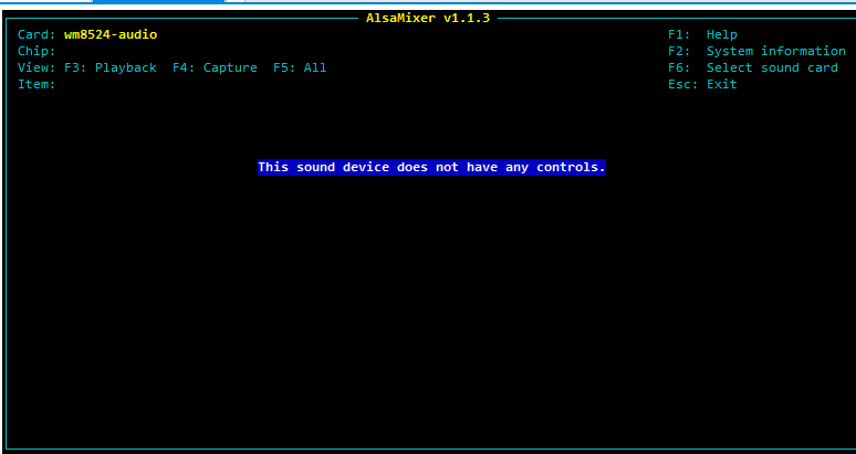

I encountered a problem in developing the voice function, in the IMX8 series development board, if you want to output audio from the HDMI port, you need to manually use the command to change the output port to HDMI, but during the development I found that all my sound card devices lack chips, in alsamixer display: This sound device does not have any controls. There is no way to adjust the volume at all, nor can you change the output device, you can only see a few sound card information, if you solve this problem so that the sound can be output normally from the HDMI port

jinmuyan
First of all, thank you very much for your help, but I also need to elaborate on my problem, my development needs are to need to output sound separately from the HDMI, and I have an adapter, it has two outputs, a headphone jack and a VGA port, I need to plug in the headphones to let the sound go through the adapter and then through the headphones, but my problem now is that I have all the sound card equipment.I can see all sound card devices including vm8524, imx-hdmi, etc. through the aplay -l command, but in ALSAmixer I have no way to adjust the volume, prompting me to lack firmware, as shown in the image below, I suspect that it may be that my burning file is incomplete, so can you analyze what caused it or tell me where to find the official standard burning file?
