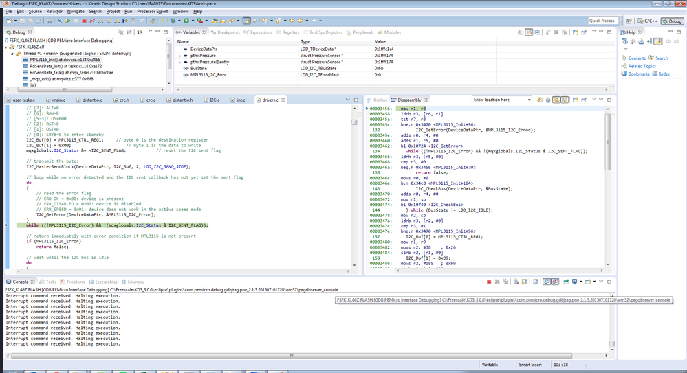

I have noticed from time to time my application hangs on startup using the sensor fusion. I first suspected my code but then I noticed something.
After several seconds of execution, pausing the execution with the debugger reveals that the program is looping forever in MPL3115_Init, waiting for I2C callback to send the 'sent' flag
Debugger shows that MPL3115_I2C_Error is 0
I am using KL46Z
My code is not interacting with any of the sensors or I2C so far.
Any idea of what is going on ?

Which sensor board are you using?  The 9-axis board does not include an MPL3115A2.  If you have a 9-axis board, or don't need the MPL3115A2 for your app, comment out the line that says "#define USE_MPL3115A2" in build.h.
2,817 Views
remibeges
Hi Michael, I am using this board, it does include the MPL_3115A2 :
http://www.freescale.com/webapp/sps/site/prod_summary.jsp?code=FRDM-FXS-MULT2-B
So far my application exchanges data with the computer through bluetooth serial port, and weirdly, the issue seems to happen more often when I leave the bluetooth serial port connected (led stays blue) and restart the debugging. I am not sure it is entirely related though, I need to make some more testing.
Is it even possible leaving serial port open on bluetooth might freeze the KL46Z I2C bus ? I find it unlikely
Is the MPL3115 the first sensor initialized or the first using I2C ?
I will try to find a consistent way to reproduce the issue

I tried removing the power jumper but then I don't receive anything at all on the usb serial port. I checked the port carefully, I am well connected to hard-wire serial.
Looking at the schematics of the shield, I believe I need instead to rotate the square jumper on UART_TX/RX in the bluetooth interface. Is that correct, can you confirm it Michael ? Haven't had the chance to test it yet
Also, I noticed an easy way to reproduce the I2C error is to remove the shield. So I suppose if a solder is bad on the KL46Z pin headers then result might be the same. I identified one potentially bad solder on the board header pins, I'll try to fix it and let you know the result

I re-done a couple of solders, the problem seems gone now. Good news :smileyhappy:
