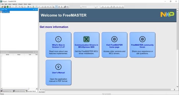

Install FreeMASTER Run-Time Debugging Tool
  • Download FreeMASTER Run-Time Debugging Tool
  • Install the tool following installer instructions.
  • Double click on installed FreeMASTER application to launch.
  • Once you launch the FreeMASTER application then you would see FreeMASTER welcome page
FreeMASTER Welcome PageFreeMASTER Welcome Page

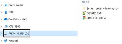

  • Check whether you see a virtual mass storage drive on your PC with name “FRDM-K22FD”.

  2. Drag & drop “frdmk22f_a89xx_i2c_project.bin” available to “FRDM-K22FD” virtual mass drive on your training PC.
  3. Once the board is programmed (bin copied successfully), disconnect and connect the USB cable between the OpenSDA USB port on the board and the USB connector on the PC.

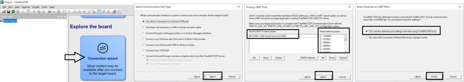

  4. Launch FreeMASTER tool and click on “Connection Wizard”. Follow the instructions described below.FreeMASTER Connection WizardFreeMASTER Connection Wizard
  5. The FreeMASTER tool identified the COM port and detected the board.

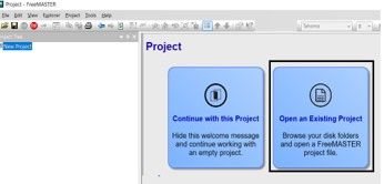

  6. Click on “Open an Existing Project”.Open Existing ProjectOpen Existing Project
  7. Browse to <FreeMASTER sensor tool directory>\sensors\fxls8974cf or <FreeMASTER sensor tool directory>\sensors\fxls86xaf
  8. Open the “FRDMK22F-A8974_FXLS8974CF_Demo.pmpx” or “FRDMK22F-A896x_FXLS896x_Demo.pmpx” project.

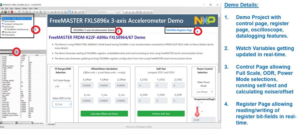

  9. This will open the out-of-box sensor demo project.Out-of-Box Sensor Demo ProjectOut-of-Box Sensor Demo Project

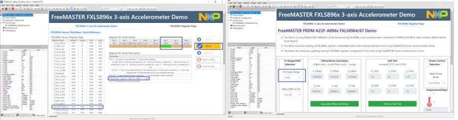

  10. Perform register read, write, read all action on “Register Page” tab. Try modifying bit-fields of register e.g. SENS_CONFIG1 bits 1 & 2 to change the full-scale range in real-time.
  11. Select SENS_CONFIG1 on register page, click on bit 1 & 2 to toggle the bit values and click on “Write” to apply the register update.
  12. Go back to control page “Accelerometer Demo” tab and see the full-scale range value changed to align the SENS_CONFIG1 register modification (changed from ±4g to ±16g in example show below).Sensor Register PageSensor Register Page
  13. Play with all the features of the sensor out-of-box demo.

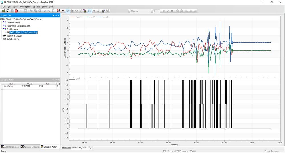

  14. Visualize data streaming by clicking on “DataStreaming”.Oscilloscope Date StreamingOscilloscope Date Streaming
