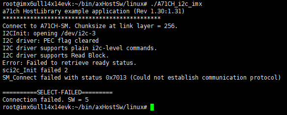

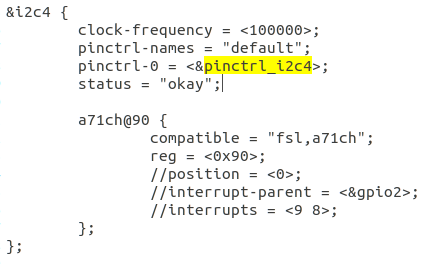

I don't use OM3710/A71CHARD with MCIMX6UL-EVKB. My device base on imx6ull-14x14-evk and A71CH connect to imx6ull via I2C4(ENET2_TX_DATA0 and ENET2_RX_EN).
And,I have configure I2C4 in the device tree.like following:
And then,I change the axHost/hostlib/platform/imx/i2c_a7.c line 39 "/dev/i2c-1" to "/dev/i2c-3". Run buildA71CH.sh all and put into my device.
I2C init will be failed, when I run axHostSw/linux/A71CH_i2c_imx, like the following:
So,I don't know why I2C failed to initialize. Is there an error in my device tree configuration?Where can I find any I2C example in device tree of imx6ull?
