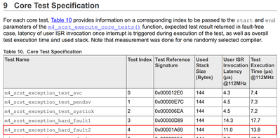

I'm using S32k144. To apply SCST, I purchased and applied SCST_M4_S32K144_RTM_1.0.10 version.
When performing a core test, an error occurs in item 4 as shown below.
It doesn't work anymore.
The development environment is using IAR 9.20.3 plug-in to s32ds arm 2.2.
What should I do?
sungjun_0-1705650229850.pngsungjun_0-1705650229850.pngsungjun_1-1705650413338.pngsungjun_1-1705650413338.png

Could you please send us a screenshot of the values of core registers and also data, which are stored on stack, when stopped at m4_scst_exception_test_hard_fault2, row269? (Please see attachment, similar values shall be stored also in your registers)
Is MPU enabled? If Yes, could you please send us its configuration?
Could you please send us map file containing SCST related sections, to know about its address allocation?

martinkaspar-r3
Thank you for the additional information.
Could you please send us the screenshot from Trace32 with execution stopped in m4_scst_exception_hard_fault2, line 383? (Please see attachment)
If line 383 is not reachable, please check line 371.
Additionally, what value does your M4_DEVICE_RESERVED_ADDR have?
Also please, what 32-bit data is stored at address 0x4A124?

sungjun
Hi. martinkaspar-r3
thank you for reply.
The current issue has been resolved.
It seems to have occurred because the Rom section related to scst was not specified in my .icf file.
After adding the ROM section, it works without any issues.
As I mentioned before, when I added a global variable or text code, scst failed, and the number of tests that failed was random.
Looking at this, it was predicted to be influenced by alignment.
Is the way I solved it correct?
Or is there a better solution?
If there are any additional mistakes I made, please let me know.
