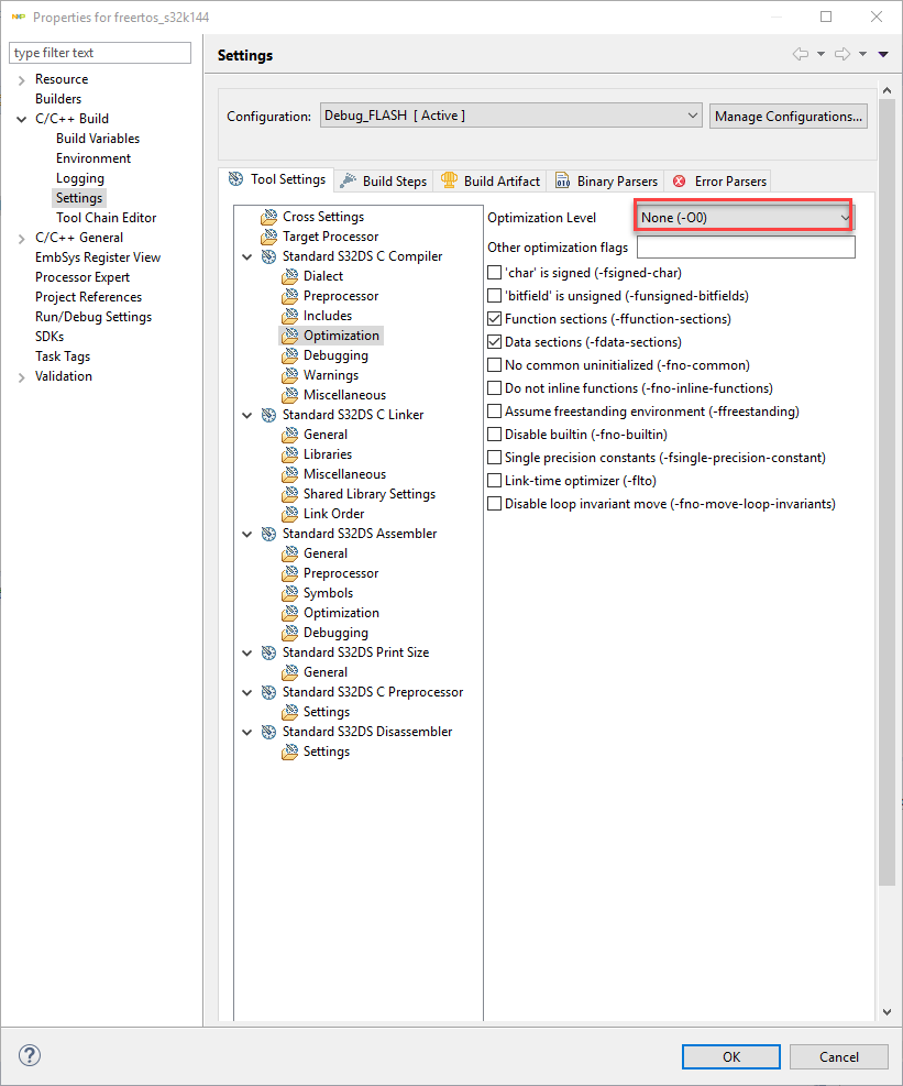

I took a look into the main.c of your folder and I notice something that I had seen before while working with FreeRTOS. In your AppTask you have the following floating-point operation:
   adcRealVol[0] = ((float) adcRawValue[0] / 256)*(ADC_VREFH - ADC_VREFL);
But, you are not using for anything the adcRealVol[0] value. By default your project has optimizations and, since you are not using this value, the compiler is optimizing it. This causes some strange behavior while working with FreeRTOS. To solve this behavior that you are facing, please turn off all the optimizations. To do this go to your project properties > C/C++ Build > Settings > Standard S32DS C Compiler > Optimization > Optimization Level and select None.
Please let me know the results on your side.

I tried as your suggestion, the problem cannot be worked out.

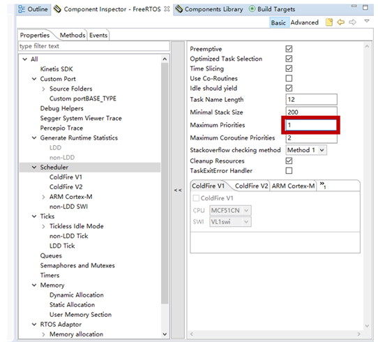

But I found that the value of “Maximum Priorities” must be 1, then the project can work normally, shown as the following fig.

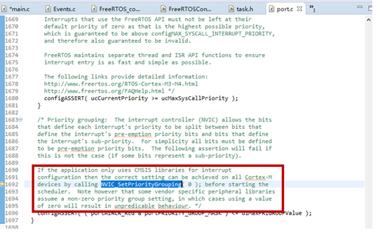

and it seems the problem is caused by the NVIC priority grouping, the illustration of freeRTOS codes ares shown as the following fig. But I cannot understand how to set the NVIC_SetPriorityGrouping for S32K144.
I read the datasheets, and I set PRIGROUP bits of register AIRCR as this:
S32_SCB_AIRCR_PRIGROUP(0x03);
which I means to set preemptive priority is 16, and subpriority is 0.
but when I debug, the value of register S32_SCB -> AIRCR is always 0 in EmbSysRegisters view.
Could you help me again?

According to the Cortex-M4 Devices Generic User Guide from ARM (link), if you want to write to this register, you must write 0x5FA to the VECTKEY field, otherwise, the processor ignores the write. For more information refer to section 4.3.5 of the User Guide mentioned before.
