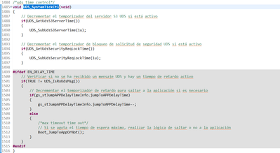

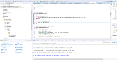

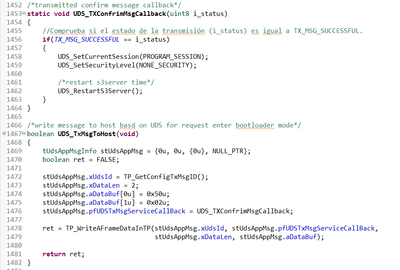

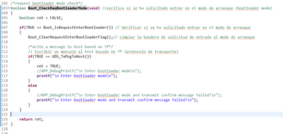

JonAnder_Amante
Hi, I am using the project "S32K344_Can_bootloader_RTD200" in the microprocessor S32K344. I want to download an application with the program of bootloader. I have achieved the jump from program to application but I have different questions. 1. I want to use #define EN_DELAY_TIME but when I uncomment the command in the folder "public_in", the program has different errors. My target to use "Backdoor", that is to say, I want to check if the program has to enter to bootloader or not. I don´t know the process and the different functions that I have to use to achieve the target. I want to use the function "Boot_CheckReqBootloaderMode(void)" but when I debug the program, it never enters to the "if". Could you explain me the process and the steps to achieve the target. I add different functions that I think are important. 2. I don´t know if I have to modificate the parameters of "static tJumpAppDelayTimeInfo gs_stJumpAPPDelayTimeInfo = {FALSE, 0u};". I have to change this structure ? You can see all structure in one of the next pictures. I need the reply as soon as possible since I have to send a project very soon.
Thank you for all,

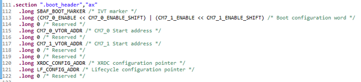

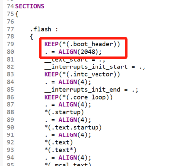

But I still have a problem, that is, I found a piece of code in the LD file, a piece of content called "boot_header" occupies 2048 bytes, I am not very clear what "boot_header" means微信图片_20231122102637.png微信图片_20231122102637.png

Hi @Jackson_Ping,
The boot_header does not occupy 2048B it is just alligned to this value.
The boot_header is defined in startup_cm7.s
RM rev7, Table 189. Image vector table
BR, Daniel
