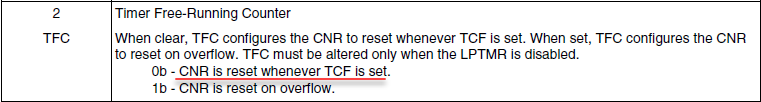

Sorry I may not understand your question, please correct me if I understand it wrong.
void LPTMR_ISR(void){
  timer_flag = true;
/* Clear compare flag */
  LPTMR_DRV_ClearCompareFlag(INST_LPTMR1);
Since you configured CSR[TFC]=0, CNR is reset whenever TCF is set.
I think after entering LPTMR_ISR, the CNR has actually been reset and will no longer increase.
LPTMR_DRV_GetCounterValueByCount can be used to check whether the CNR is still increasing.

With your insight I was able to determine where I had a logic error.  The timer was getting restarted when it was not desired to restart.
In my ISR now I do:
1) set a flag for program code
2) LPTMR_DRV_StopCounter()
3) LPTMRM_DRV_ClearCompareFlag()
then in the program code when I want to start the counter all I need to do is call LPTRM_DRV_Init(inst, config, TRUE).
This works swimmingly as a one-shot.   Documenting here because the only examples I found were for periodic timing.
