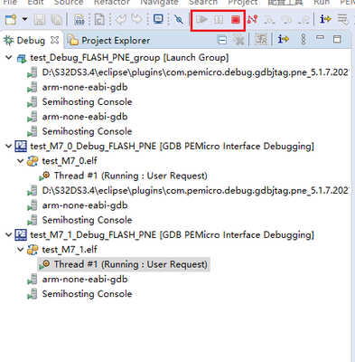

When I unlocked the S32K344 into a dual core, I debugged the project and found that core 1 was running automatically.
When I double-click the core 1 project to try to pause core 1, the core 1 application runs away.The project tried to run normally on the S32K324 chip, but not on this processor.
 It is known that the date when the chip downloaded AB Swap firmware and its screen printing is 2029A, whether this has an impact on debugging dual-core, or is there any way to solve this problem.

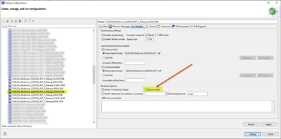

when using "Launch Group", both cores run the code up to main function by default. If you can see described behavior of core 1, something wrong obviously happened in startup files.
You can try to do this configuration before launching the group:
In this case, the code on core 1 is not executed, it's stopped on reset handler, so you can step the code to find out what's wrong.

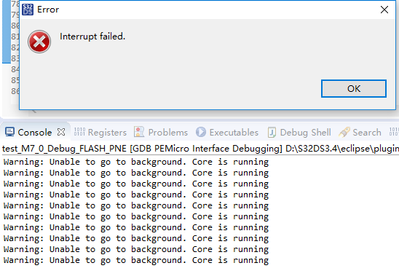

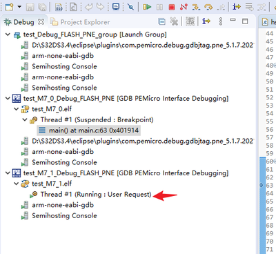

I cancel the run on reset of the core 1 project according to your operation, but it will still run automatically when debugging.
I first run the core 0 project, and then double-click the core 1 project to try to stop it, but it is still unsuccessful, showing "Interrupt failed".
I tried to debug S32K324 with this project, and it can be debugged normally. Is there any configuration that needs to be operated after S32K344 is unlocked to dual core, or is it because the chip is an early sample and the its screen printing is "2029A", so there will be this problem?

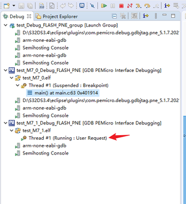

S32K324 does not have HSE firmware installed, only S32K344 has AB swap firmware installed.
I create new empty multicore project in S32DS for S32K324, but it  doesnot work on S32K344 switched to dual core and core 1 still runs automatically.
