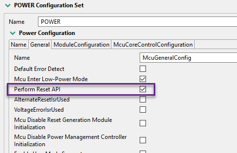

IDE is S32DS3.4
RTD is S32K3 RTD AUTOSAR 4.4 VERSION 2.0.0
There is no example program in the IDE, could you help me to get a example about how to manually trigger one Function Reset? thanks!

Hello @KerryJ,

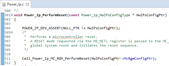

This is a part of the Power driver API.
Enable the API in the Configuration tool:
Call the Power_Ip_PerformReset() function:
BR, Daniel
