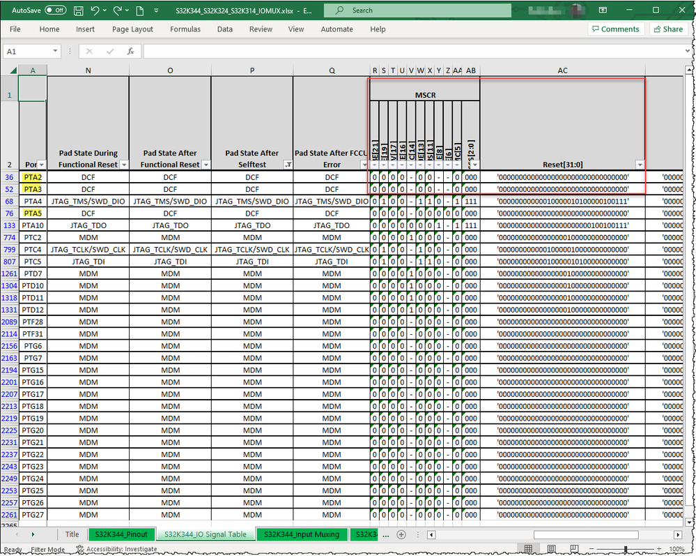

I would like to understand a little more about the reset status over the pins that we can see in the SK344_IOMUX.xlsx.
1) What does DCF mean?
2) And, if I would like to get the pin state on boot, before reach the "void main(void)" point, would I have to get the "Pad State After Selftest" column, correct?
3) Is there a default state for direction (input/output), Driver type (push-pull/pullup...), alternate function and drive strength?
4) What is the difference between DCF and MDM?

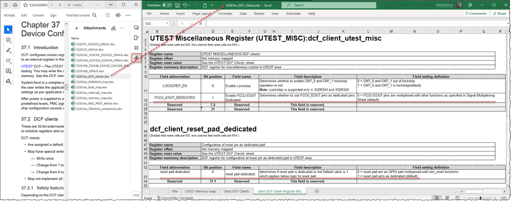

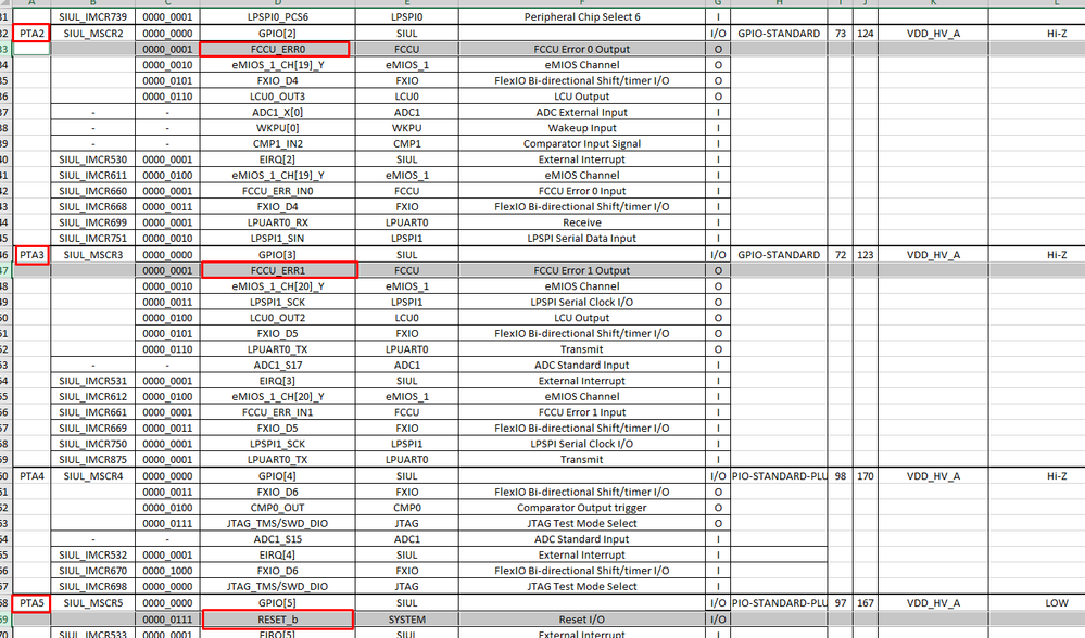

A1: PTA2 and PTA3 are allocated to FCCU fault output and PTA5 is for RESET_b. These pins can be configured via DCF records.
For FCCU: These pins will behave based on fault protocol used. Refer to chapter 53.3.5 EOUT interface of S32K3XXRM Rev.7.
S32K3xx_DCF_clients Utest DCF Client Register Bits.pngS32K3xx_DCF_clients Utest DCF Client Register Bits.png
A3: See the MSCR reset value of the AC column, which contains these functions.
MSCR Reset value S32K344_IO Signal Table.pngMSCR Reset value S32K344_IO Signal Table.png
