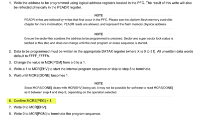

Hi @Venu_M
attached are possible reasons. The first one is usually the source of issues.
Lukas

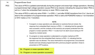

First step is to check the PEG flag:
Second step is to read the programmed data back from flash for confirmation it was programmed correctly. Notice that it may be necessary to invalidate the data cache if data cache is enabled and if previous data are already cached.
And two important notes:
1. User is allowed to program only fully erased double-word. Cumulative programming is not allowed.

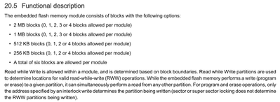

2. Read-while-write is supported only between read partitions / blocks. It is not possible to access a partition which is being programmed or erased. The code must be executed from another partition or from RAM.

PEG bit field is 0. What i have to change?

Hi @Venu_M
Lukas
