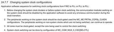

the system runs from FIRC after reset by default. Clock should be initialized using this procedure:
To change HSE_CLK, it's important to wait till HSE is in idle state:
 and
Lukas

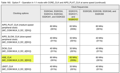

I need to add some information that I just found in RM.
In RM(Rev8). The Table 145 Option F is set to 80MHz for HSE_CLK. But inTable 160 option F, The HSE_CLK is set for 60Mhz for S32K312. can you tell me which one I should follow?
8,024 Views
lukaszadrapa
OK, but Option F expects HSE_CLK 60MHz:
But you wrote earlier that your HSE_CLK is 80MHz. I believe that it will work if you lower the HSE_CLK to 60MHz.

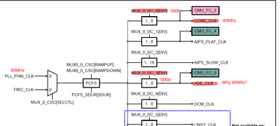

Yiming2
I think there are something is wrong in Table 160(option F). Because as the description of Figure 57. In the PLL_PHI0_CLK=80MHz, When MC_CGM.MUX_0_DC_0[DIV](used for CORE_CLK) = '000b' and CORE_CLK=80MHz but why MC_CGM.MUX_0_DC_3[DIV](Used for HSE_CLK)='000b' and HSE_CLK=60MHZ? it is unbelievable for us.

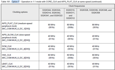

lukaszadrapa
Well, it will be fixed in next revision of RM and it will look like this:
I'm still waiting for confirmation if HSE_CLK 80MHz can be set by software or if it is necessary to configure FXOSC in UTEST etc. I will let you know later.

lukaszadrapa
Ah, ok, good point. There's obviously something wrong and it needs to be fixed. Let me check this with AE team. I will let you know later. Notice that it may take some time.
