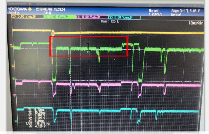

I am using the AD function of S32k142,start AD function every 50us,and collect 5 channels every time.Now, I find that the voltage of the port being collected will be pulled down.
Inside the red box,The high level voltage is pulled down to 4.1v,Under normal circumstances, the high level voltage should be 4.8v.I want to know why the voltage is pulled down and how to solve this problem.
The code:

What is the source resistance of the measured signal?
Please see Section 6.4.1 ADC electrical specifications in the S32K1xx Datasheet rev.9.
And AN12217, S32K1xx ADC guidelines, spec and configuration, Section 2.2. Sources of error in ADC measurements
