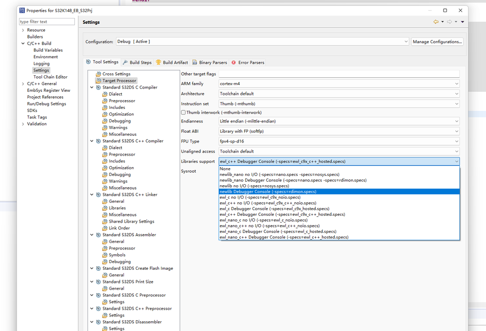

hi:
    I want to use the printf function on the console to print some information while debugging on the S32 Design Studio IDE.
    But what do I do when I re-select the library and the following error occurs when I compile?
    Platform:S32 Design Studio for ARM Version 2.2
    Chip:S32K148
3 回复数

Hi @Embedded_novice
You need to use lib C with Debugger console:
The printf output is shown in the Semihosting console.
B.R.
VaneB

Embedded_novice
I have tried.
I am not the one who created this project. I wonder if there is any way to adapt C++ to C if C++ and C do not share certain parts of this library.
Thank you again @VaneB

Hi @Embedded_novice
C++ and C have specific differences between them. If you plan to adapt your project, we recommend you investigate these differences first.
