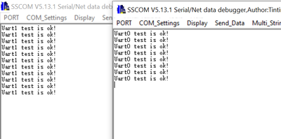

Senlent
Hi@vamsid
I modified this demo and did a test.
1. The baud rate is set too high, your module clock is only 8MHz, but your baud rate is set to 1000000
2. Since the interrupt reception is used, why use the timer to regularly read the serial port data?
I changed the baud rate to 9600 and made the following changes, and it has been working for a long time without any problems:
below is my test result.
