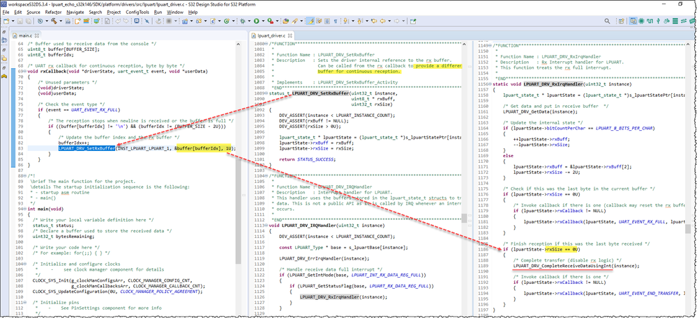

Hi.
I implement that the data send and receive through UART.
But there is an issue.
LPUART_DRV_CompleteReceiveDataUsingInt is not called after all data is received like the attached file.
below is the code which I implement.
but LPUART_DRV_GetReceiveStatus doesn't exits because LPUART_DRV_CompleteReceiveDataUsingInt is not called in the below code
what do I resolve this issue?

Hi Hyunung Park,
Did you change the value of BUFFER_SIZE according to your needs? Otherwise the LPUART_DRV_SetRxBuffer in rxCallback will trigger continuous reception without enter LPUART_DRV_CompleteReceiveDataUsingInt.
Robin

HyunungPark
Hi Robin.
This issue is resolved.
Thank you for your support.
