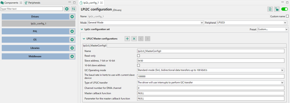

We are now using S32K146 for development. I want to use PTA0 and PTA1 as LPI2C port.
In S32DS sample(lpi2c_master_xxx), PTA2 and PTA3 are used as LPI2C port.
On my board for development, When I tried to modify PTA2/PTA3 to PTA0/PTA1 using same configuration, the is no waveform that output from PTA0/PTA1, but when I changed PTA0/PTA1 to PTA2/PTA3, there is waveform that output from PTA2/PTA3. By the way, there is pull-up resistance on PTA0/PTA1.
Could you please tell me the reason why there is no waveform from PTA0/PTA1?
Is there some difference between PTA0/PTA1 and PTA2/PTA3 when used as LPI2C port?
Attached is my screenshot of my configuration.

Please refer to the following discussion:
On S32K144, PTA0 and PTA1 port can not be used as I2C SCL and SDA?
LPI2C Master in S32K116

Now, I have another problem.
Last week, I use PTA2/PTA3 as LPI2C with internal pullup registers, it worked.
But now, I use PTA2/PTA3 as LPI2C with outside pullup registers 2.2k, it didn't work.
Is there any request with pullup registers?
Thanks!
1,254 Views
Robin_Shen
Please check the value of PORT_PCRn[MUX][PE][PS]. Did you select the pins as I2C function and disable the internal pull resistor?
Check the I2C pin voltage, is the voltage being pulled high?
