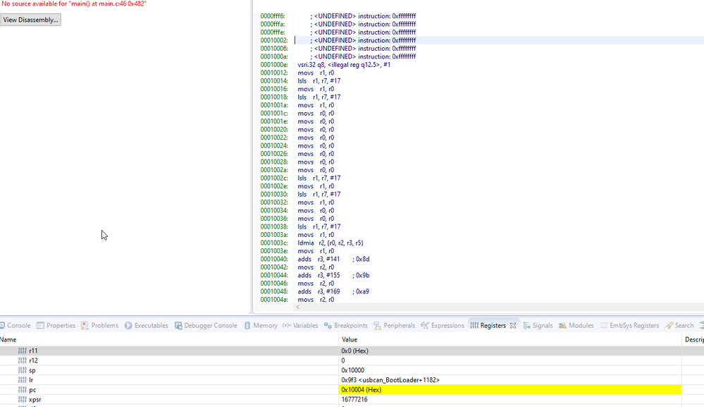

When i set a breakpoint on the last instruction i.e __asm("mov pc, r1"); it jump to unknown code:
But as you can see in the register view, i can see that sp is set to 0x10000 and pc is set to 0x10004.
I tried different addresses for setting PC, as 0x10410 but it doesn't jump at my start code application, i know it since i have set a Debug flag as in this article and a breakpoint with a condition on r11, and it never reach my flag..
Any ideas of what can be wrong ?

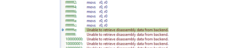

Ok i see how r0 and r1 are set, now they have the value in memory at address 0x10000 and 0x10004, but it seems that my userSP and Startup are erased, since they are equal to 0xFFFFFFFF. Which are the values at theses addresses, but not what i want.
6,039 次查看
danielmartynek
Can you open 0x10000 - 0x10004 in the Memory view, not Disassembly.
6,037 次查看
BriceC
As you can see values at 0x10000 and 0x10004 are 0xFFFFFFFF
6,033 次查看
danielmartynek
I don't even see a valid stack address in the whole memory range you posted.
There should be something like 0xXXXXXX20 (SRAM_U) or 0xXXXXXX1F (SRAM_L), depending on the location of the stack.
There is clearly something wrong with the bootloader.
Check the SREC file of the application and see how it is being programmed by the bootloader.
BR, Daniel
