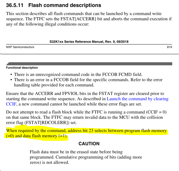

lukaszadrapa
Hi Jay,
good question. There's a note in the RM which can be easily overlooked:
So, if you are going to program address 0x1000_0000 then write these values to FCCOB registers:
FCCOB[1] = 0x80
FCCOB[2] = 0x00
FCCOB[3] = 0x00
Lukas

Thank you very much for your reply! I'm now able to successfully write to the D-Flash memory. I must of missed that paragraph when reading through the manual.
