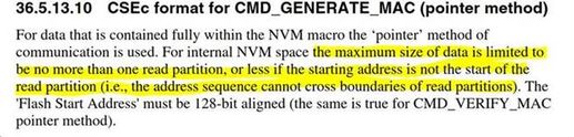

Hello NXP team,
We are using mac generation and verification mechanism using CSEc using pointer method for secure boot functionality.
As mentioned in below snap from S32K reference manual, We can use maximum size of data limited to be no more than one read partition, or less if the starting address is not the start of the read partition.
In our case we are using S32k148, so maximum CMAC can be calculated on 512KB program flash block.
For our project, application area is from 0x50000 – 0x11FFFF which is spread over two read partitions.
In this case we are facing the issue of CMAC calculation over application area. Please suggest the way to perform MAC operation in this case. Please provide sample code if possible.
We tried to check application note AN4235 but it's not clear so requesting you provide support.

the secure boot itself can cover up to 512KB (i.e. one partition). The start address for secure boot is always 0x0 and it cannot be changed.
If you need to cover also rest of the flash, it is necessary to create a chain of trust: code (typically a bootloader) starting at 0x0 which is protected by secure boot should calculate and compare CMAC over next required areas. If these areas are spread over more partitions, it is necessary to calculate more CMACs. Based on the result, the code can execute CMD_BOOT_OK or CMD_BOOT_FAILURE command, so the application can or cannot use boot protected keys.
AN4235 was written for MPC5646C, you should follow this one (examples included):
https://www.nxp.com/webapp/Download?colCode=AN5401&location=null
https://www.nxp.com/webapp/Download?colCode=AN5401SW&location=null
