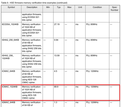

Hello, I'm using S32K312 micro in the project. During evaluation of AES CMAC generation/verification on 1mb of data by HSE it turn out that the time of this operation is not acceptable - too long. After analysis of RM it seems that it shall be possible to speed up this operation by enabling PLL for HSE clock, but it's not straight forward mention how to do this, and I would like to not brick my board for any reason.

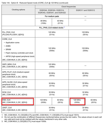

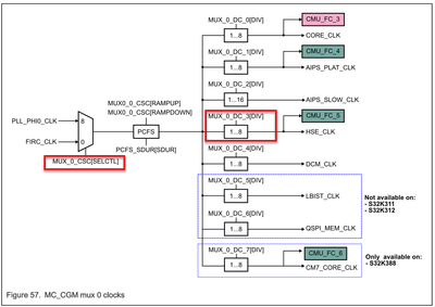

If you do not need this, it is sufficient to configure the clock in your application. In case of S32K312, you can use configuration HSE_CLK = 120MHz and CORE_CLK = 120MHz (this is called "Option B" in HSE and S32K3 manuals).
By default, the HSE runs from FIRC clock, so make sure that HSE_CLK is configured to 120MHz:
And then here's what you can expect:

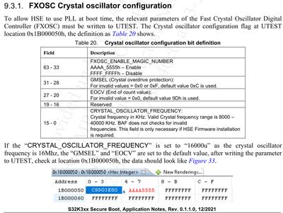

If you want to enable the PLL at boot time, it is sufficient to program 0x1B000050 accordingly. This is a screenshot from secure boot application note (you can find it in Secure Files section on S32K3 main page):

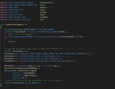

What is the configuration format of this FXOSC clock? look at your screenshot and write UTEST as 0xC9D0 3E80 AAAA 5555. It looks like a 32-bit little-endian , but write 2 bytes at a time.

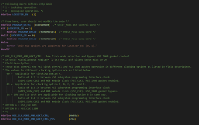

I found that one more thing is necessary:
 For Option B, it is necessary to program the dcf_client_utest_misc as mentioned in the screenshot.
 HSE_CLK_MODE_AND_GSKT_CTRL needs to be 10 or 11.
Then also double check if all your clocks meets requirements listed in the Table 144 in the RM.
Similar issues are usually caused by wrong clock settings, so I believe this will solve the problem.

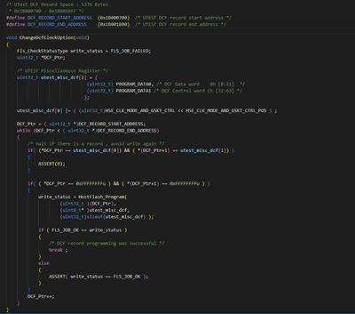

If it helps, attached is sample project which shows how to modify the dcf_client_utest_misc. You just need to port this to S32K312, check first available position in the UTEST and program the DCF accordingly. Notice that it is OTP area.

Hi, after configuration of DCF record for UTEST_MISC still I'm observing same issue, but I'm not sure if it's taken into account by MICRO. In memory it looks in following way:
but in register DCMROF21 still I can observed 0 for HSE_CLK_MODE_OPTION
Is there any other register which shall be set in order to eg. DCF record configuration was taken into account?
Since I'm using different toolchain (compiler) I wasn't able to run sample app which you provide, but I used debugger to program DCF record directly from binary, and seems it was done currently. Do you have any idea why my DCF record configuration is not taken into account?

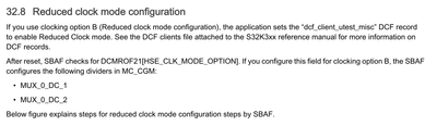

I just got new information. This configuration of HSE_CLK_MODE in DCF record (and also configuration of FXOSC) has no effect unless PLL_ENABLE in IVT is enabled. SBAF will ignore it and FIRC will be used at boot time. And PLL_ENABLE has effect only when BOOT_SEQ is 1 (i.e. secure boot enabled).
I'm sorry, I provided wrong information in previous post. The documentation is little bit confusing here, I will ask to clarify it.
Based on HSE_CLK_MODE_OPTION (if PLL_ENABLE is set), SBAF configures MUX_0_DC_1 and MUX_0_DC_2 dividers. If PLL_ENABLE is not used, it's up to user to configure these dividers later in the code. So, we are getting back to Table 144 in the S32K3 RM. Could you send me your clock configuration? Is it the same as in Table 144?
If my FXOSC is 40MHz, how should I configure MUX_0_DC_1 and MUX_0_DC_2 , SBAF will automatically adjust?

Hi, from my point of view clocks are configured accordingly, I send configuration in separate NXP ticket.
In addition as I mentioned for HSE_CLK == 60Mhz (div is set), the HSE is working correctly (I can perform HSE jobs and get the version etc.), but when I remove div for HSE_CLK to have 120Mhz then mentioned issue is observed (SBAF removes HSE FW since most probably handshake fails). Today I even updated SBAF successfully on HSE_CLK == 60Mhz to have compliant version to HSE FW, but again when I changed HSE_CLK divider to have 120Mhz issue still is observed.

For DCF and FXOSCU configuration code implementation, you can refer to the screenshot below.
wuxianlong_1-1714275723899.pngwuxianlong_1-1714275723899.pngwuxianlong_2-1714275757565.pngwuxianlong_2-1714275757565.pngwuxianlong_0-1714275648381.pngwuxianlong_0-1714275648381.png

thank you very much. I have another question. Why it works in HSE_CLK=60MHz, if I set the Core_CLK=80Mhz, what HSE_CLK should be configured?(I am using S32K312NH)

This is highly discouraged. Unknown anomalies may occur in the peripheral function of S32K312 and the function of HSE. S32K3xx clocks should follow < S32K3XXRM > Clock- > Clocking details- > clocking configurations, and choose the correct Option.
