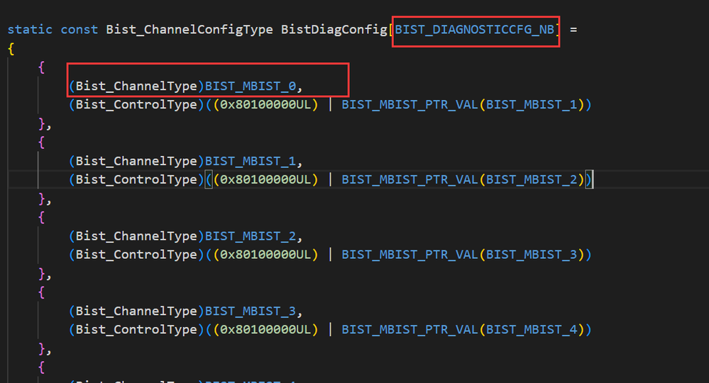

We have allocated a Standby RAM segment in linker_flash_s32k344.ld file in our project (as shown in the figure below) to store relevant data during Standby mode and for use in the next run mode. However, recently I discovered that the content of the Standby RAM region gets corrupted after our project completes the BIST self-test.
  1. Does the BIST self-test corrupt the content of the Standby RAM region?
This is crucial for our project as we need to use the Standby RAM to save data.

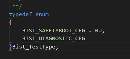

Our project currently uses the S32K314 chip, so it only supports online mode.
At the same time, we are using the SPD 1.0.0 library to run BIST. Since SPD only provides two online configurations (BIST_SAFETYBOOT_CFG and BIST_DIAGNOSTIC_CFG), both of these configurations include MBIST0, which is SRAM0 (the area where StandbyRAM is located).
Therefore, we cannot directly call the SPD library to preserve the data in the StandbyRAM area.
  1. How can I modify the program to preserve the data in the StandbyRAM area?
I am looking forward to your reply. Thank you very much!
I was talking to the SW team. SPD driver do not offer such possibility.
However they had already such questions and the recommendation is to store that content in NVM in order to preserve it.
