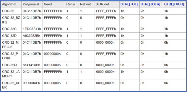

Hi Team,
I am using CRC module to generate checksum in s32k146. Is there any tool to calculate the checksum manually to verify the checksum generated?
The configuration used for checksum calculation is:
* 32 bit CRC protocol
* Seed value : 0xFFFFFFFF
* Polynomial : 0x4C11DB7
* Bit reversal is enabled on both input and output (Bits in bytes are transposed, bytes are not transposed)
* CRC result inverse is enabled
1,705 Views
Senlent
Hi@Jusaira
try this online CRC calculation
https://www.lddgo.net/en/encrypt/crc
and the CRC32 algorithm supported by S32K is as follows:
