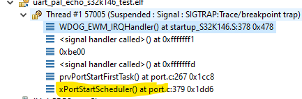

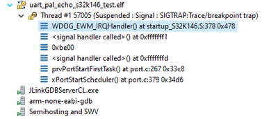

i have added freertos component to my project which was uart_pal_echo_s32k146, the problem is code is getting stuck in prvPortStartFirstTask, this is something new and i have no idea with respect this how to troubleshoot. can you share any details or guideline to troubleshoot this problem;

FreeRTOS_org
Your stack frame shows the WDOG interrupt is executing, which I presume is the watchdog timer expiring.  Are you knowingly using the watchdog timer?  If so, it might be doing what it is supposed to be doing and letting you know it wasn't reset in time.
5,496 Views
FreeRTOS_org
You stack frame shows you are in the WDOG interrupt - which I presume is the watchdog interrupt - are you using the watchdog timer?  If so, I guess the watchdog is expiring.
5,550 Views
FreeRTOS_org
Does it appear to get stuck on the SVC instruction which starts the scheduler?  If so, often users report the code appearing to get stuck here whereas in reality the tasks are running.  Try placing a break point at the start of the highest priority task (which might be the auto-generated timer task), run the code (not stepping through the code), and see if the break point is hit.

Single stepping i can deduce that in task2 i am creating an xEventGroupCreate(); , the debugger disappears from here to default to ISR.
