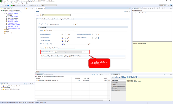

if you mean the example under "C:\NXP\SW32G_RTD_4.4_3.0.2_HF01\eclipse\plugins\I2c_TS_T40D11M30I2R0\examples\EBT\I2c_HLD_Transfer_S32G274A_M7"
No, in my humble opinion this is unfortunately not an AUTOSAR example. you can see it in the Tresos Base module configuration, it is configured as "BareMetal".(as such it compiles - but this does not prove me wrong, because my use case is AUTOSAR, not bare metal).
Moving to AUTOSAR has quite an impact on the source code through conditonal compilation, in all places with
#ifdef USING_OS_AUTOSAROS
When I change this setting only on the fly, I run into different compilation problems which I think arise from the fact there is no proper AUTOSAR Os in this example project or in the RTD stack. Among other things,  the OS should define the ISR() macro as per AUTOSAR conventions. I gave up converting the I2c_HLD_Transfer_S32G274A_M7 example into a proper AUTOSAR example.
