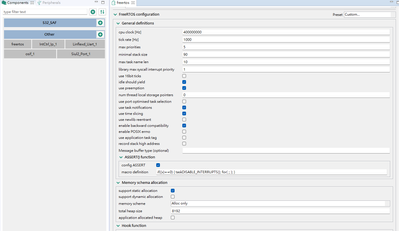

Hi NXP,
There is an build error if I try to select "“support dynamic allocation” setting.
Could you help to confirm the dynamic allocation selection support on FreeRTOS?
Following are my procedure.
Building target: Linflexd_Uart_Ip_Example_S32G274A_M7
If we use “support dynamic allocation” setting, the build will be success.
If we select to “support static allocation”, the build will be failed and come out following error message.
Thanks.

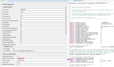

Regarding the "configSUPPORT_STATIC_ALLOCATION", this can be modified within Config Tools, as shown below:
And it should automatically, once the code is updated, replace the previous configuration with the newer one.
