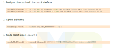

When I tried to confirm the LLCE function as blow:
the function was confirmed correctly, but the dmesg information was a bit strange

[   65.368085] llce_can 43ff8000.llce:llce_can0: LLCE FW error 53
[   65.368113] llce_can 43ff8000.llce:llce_can0 llcecan0: Advanced RX filter not added. Logging feature not available.
[   65.370492] IPv6: ADDRCONF(NETDEV_CHANGE): llcecan0: link becomes ready
[ 1384.057054] llce_can 43ff8000.llce:llce_can14: LLCE FW error 53
[ 1384.057084] llce_can 43ff8000.llce:llce_can14 llcecan14: Advanced RX filter not added. Logging feature not available.
[ 1384.062005] IPv6: ADDRCONF(NETDEV_CHANGE): llcecan14: link becomes ready
Why is the following information output and how can I modify it
[ 6.272311] llce_mb 43a00000.llce_mb: LLCE firmware: logging support disabled
[ 72.719488] llce_can 43ff8000.llce:llce_can0: LLCE FW error 53
[ 72.719515] llce_can 43ff8000.llce:llce_can0 llcecan0: Advanced RX filter not added. Logging feature not available.

5,630 Views
ghennadi_procopciuc
Hi @StanleyShen ,
This message lets you know that the firmware you are using does not include support for LLCE CAN logging:
