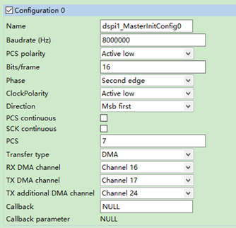

There are some problems with API DSPI_MasterTransfer() generated by SDK recently, SDK version 3.03, the MCU is MPC5744P:
DSPI is configured as a DMA transmission mode, as shown in Figure 1575693394_0-1694342456652.png575693394_0-1694342456652.png
Figure 1

DSPI status is updated in DSPI_DRV_MasterCompleteDMATransfer which is callback function for RX DMA channel. So if RX DMA transfer is completed, its interrupt should be called if interrupt priority is higher then interrupt from which transfer was started. Try to check priorities of used interrupt.
BR, Petr
