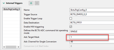

Hello everyone,
1) When I try to setup the ADC to work together BCTU, the setup only works if we using ADC_0 and BCTU_0.
If I change ADC_0 to ADC_1, the notification doesn't work.
I used the example "Adc_Sar_Bctu_Ip_example_S32K344", this example is configured using ADC_0, BCTU_EMIOS_0_0 and BCTU_FIFO1. If I change the ADC_0 to ADC_1 it doesn't work. Why is it occur? (I am testing the part 2 of this example "Part 2: The sequences of conversion is triggered using SW triggering from BCTU, the ADC results are stored in FIFO index 1").

PetrS
1) most probably you forgot to modify BCTU trigger config to use ADC1 instead of ADC0, refer to "Adc Target Mask" item. it is a mask, so value 1 is ADC0, 2 is ADC1 and 4 is ADC2
