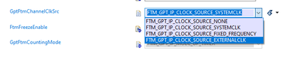

GPT FTM channel clk src=system_clock

GPT FTM channel clk src=system_clock  -> FTM clock is gotten from System clock of MCU module. So even you configured SPLL div 1 to 40 Mhz, FTM doesn’t get this source clock
If you want to keep GPT FTM Prescaler = 32 , then check that your System clock equals 40Mhz
It’s Run System Clock Frequency (Hz) (dynamic range)  attribute in MCU (/Mcu/McuModuleConfiguration/McuClockSettingConfig/McuRunClockConfig/McuSystemClockFrequency)
This attribute corresponds by Run System Clock Select. So you can modify these attributes to get value 40Mhz

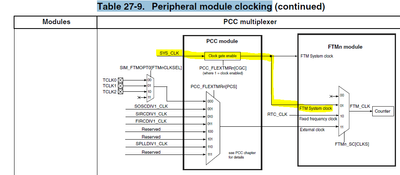

For more information, you can check Reference Manual doc Chapter 27, Table 27-9. Peripheral module clocking to know about Clock source select for FTM:
In case you want to keep Source clock is SPLL, you can change  GPT FTM channel clk src to External clock
