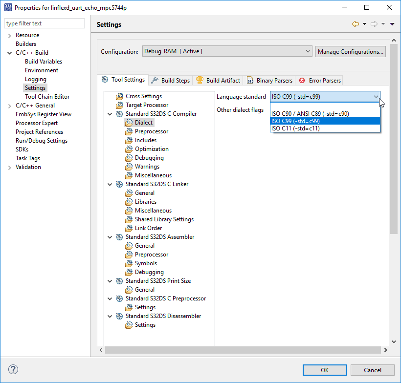

At location “C:\NXP\S32DS_Power_v2017.R1\S32DS\e200_ewl2\lib”  there are various  libraries with the following names
libc.a, libc99.a, etc.  I’m assuming for me (since I’m using C) I would need to link to the libc.a library right? –
I’m confused here because in the article you show a picture linking to an EWL library – I don’t have library with that name.

#2 - The EWL C library version depends on C dialect. By default - you don't need to specify C library explicitly in linker options. S32DS will pick up version based on Project settings:
Hope it helps.
