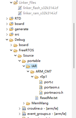

Hello, for functional safety reasons, I need to use IAR to generate compilation files, so I followed the tutorial below to set up the project:HOWTO-Export-S32DS-Project-to-IAR-EW-S32K14x-S32K11x/ta-p/ 1122428
I added freertos to the peripheral, but found that the portable file added was GCC:
After finding a replacement file suitable for IAR, the compiler found an error. I guess the Link file generated by 32DS is not adapted.
Compared with the original file found a new file in the assembly file"portasm.s".
This compiles an error:
"Error[Lc036]: no block or place matches the pattern "ro code section CODE in portasm.o symbols: [SVC_Handler, vPortStartFirstTask, vPortEnableVFP, PendSV_Handler]""
Attached is the "icf" file for IAR generated by S32DS3.5

wanglei_henson
请问问题有没有解决?我也遇到了同样的问题
2,076 次查看
Faith-Herio
官方答复不支持
2,071 次查看
wanglei_henson
我解决了,是因为.icf文件里面没有CODE的section,需要把CODE替换为你的icf中有的section,比如我的icf里面有.data的section,就要改成 RSEG .data:CODE(2)
