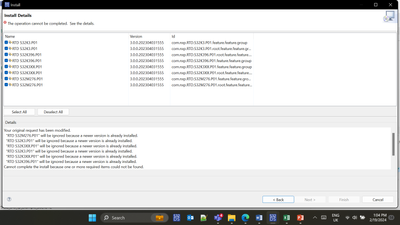

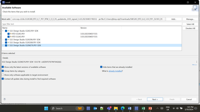

Attempting to install package, which is not being installed for NXP S32K312 3.0.0 SDK.
but the result showing is Your original request has been modified.
"RTD S32M276.P01" will be ignored because a newer version is already installed.
"RTD S32K3.P01" will be ignored because a newer version is already installed.
"RTD S32K3XX.P01" will be ignored because a newer version is already installed.
"RTD S32K396.P01" will be ignored because a newer version is already installed.
Cannot complete the install because one or more required items could not be found.
Software being installed: RTD S32M276.P01 3.0.0.202304031555 (com.nxp.RTD.S32M276.P01.root.feature.feature.group 3.0.0.202304031555)
Missing requirement: RTD S32M276.P01 3.0.0.202304031555 (com.nxp.RTD.S32M276.P01.root.feature.feature.group 3.0.0.202304031555) requires 'org.eclipse.equinox.p2.iu; com.nxp.s32ds.s32m2.dev.feature.feature.group 1.0.0' but it could not be found
how can it solve this issue?
i need to work in 3.0.0 packages.Im getting error ,when i attach 3.0.0 sdk .
But the code is working fine with 2.0.1 package sdk.
how to make the code working in 3.0.0.. Is that installation error or anything else?

Hi @JIBIN_7
To install the RTD drivers for S32K312 devices, you do not need to install the package for S32M276 devices.
If you also want to install the RTDs for these devices, please make sure to have installed the corresponding development package.
Also, if you have the latest RTD releases and you want to use specifically version 3.0.0 P01, uninstall them because S32DS uses the latest release instead of the latest install.
B.R.

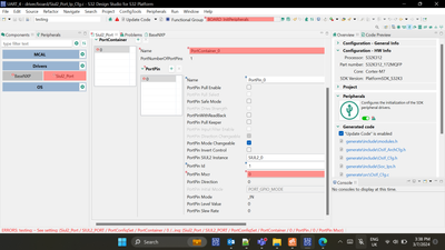

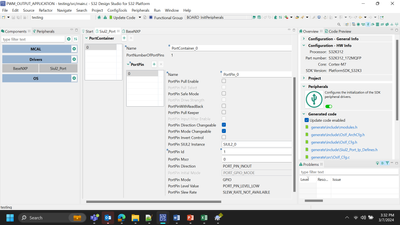

The above screenshot attached is from my colleagues laptop, we have installed same packages,but for me
kindly reply the solution asap.
there's a difference in Port pin Mscr and port pin level, value slew rate , port pin  direction

Hi @JIBIN_7
Check the following community post. It has information related to this error that should be useful for you.
S32K344 Port Configuration Problem
