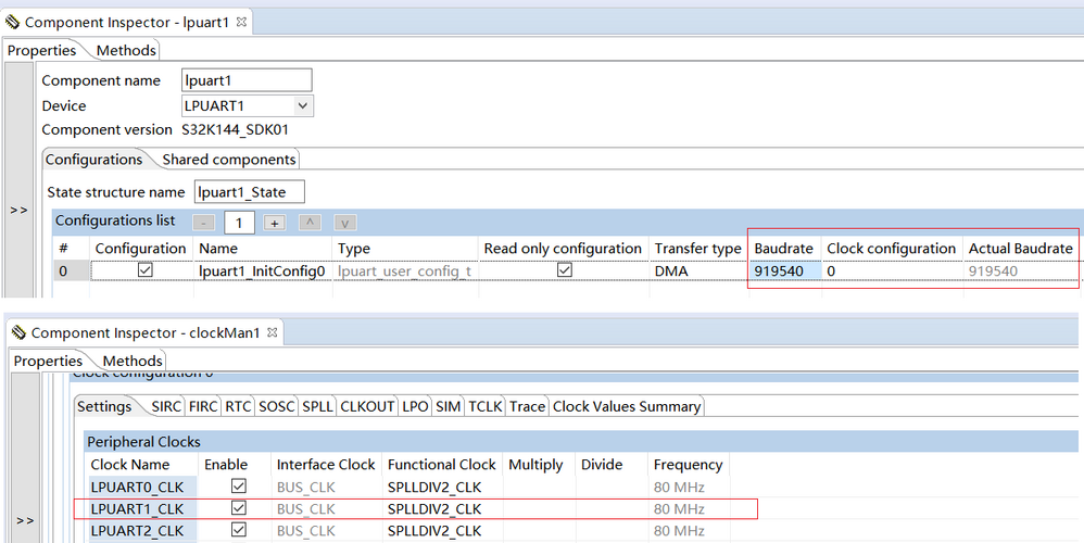

I'm using a development board S32K146 and working with the LPUART, i did the configuration using the SDK 8.5.
The configuration is:
Baud rate: settled as 256000 (no option to set it as 921600)
Parity: no parity
Stop bits: 1
Data: 8 bits
8 bit data + 1 stop bits + start bit
I've change the pins to LPUART0
Tx -> PTB1 output
Rx -> PTB0 input
I configured the FIRCDIV2_CLK at 48MHz as input clk
Using the code example lpuart_echo_s32k146, to get the desired baud rate I write before the initialization of the instance:
lpuart0_InitConfig0.baudRate = 921600U;
Tx communication is successful, frames are written correctly, but when I send the "Hello Board \r\n" string, I don't have the response back.
If I just low the baud rate to the fastest in the SDK the code works as expected...
Any suggestions?

wjandsq
you can  use  the value "919540",   it  work is very well.
1,651 Views
wjandsq
it support  460800bps,I do belive .  921600 bps不稳定。1000000 bps 似乎可以,忘记了。
