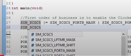

hello buddy ,
i am a fresh to NXP codewarrior , i meet a problem that my CW could not prompt content automatically
but i see others are able to do it ,
for example ,  i define a struct example  ,  when i type "struct." noting will appear after "."
but others will apprear related content .
anyone can help me ,thx

1,808 Views
stanish
It seems that the definition you expect to be automatically prompted is outside of any valid C function/declartation block.
Please try to add "PARTID1STR." e.g. into a valid C function such as main()  within the same module and the prompt should pop up if there is no other syntax conflict.
Other option is the the file you added the union definition is not indexed by Eclipsed e.g. due to header file size. (see the Indexer properties screenshot below). but this would mean e.g. your source file is >8MB which is probably not the case.
Hope it helps.
