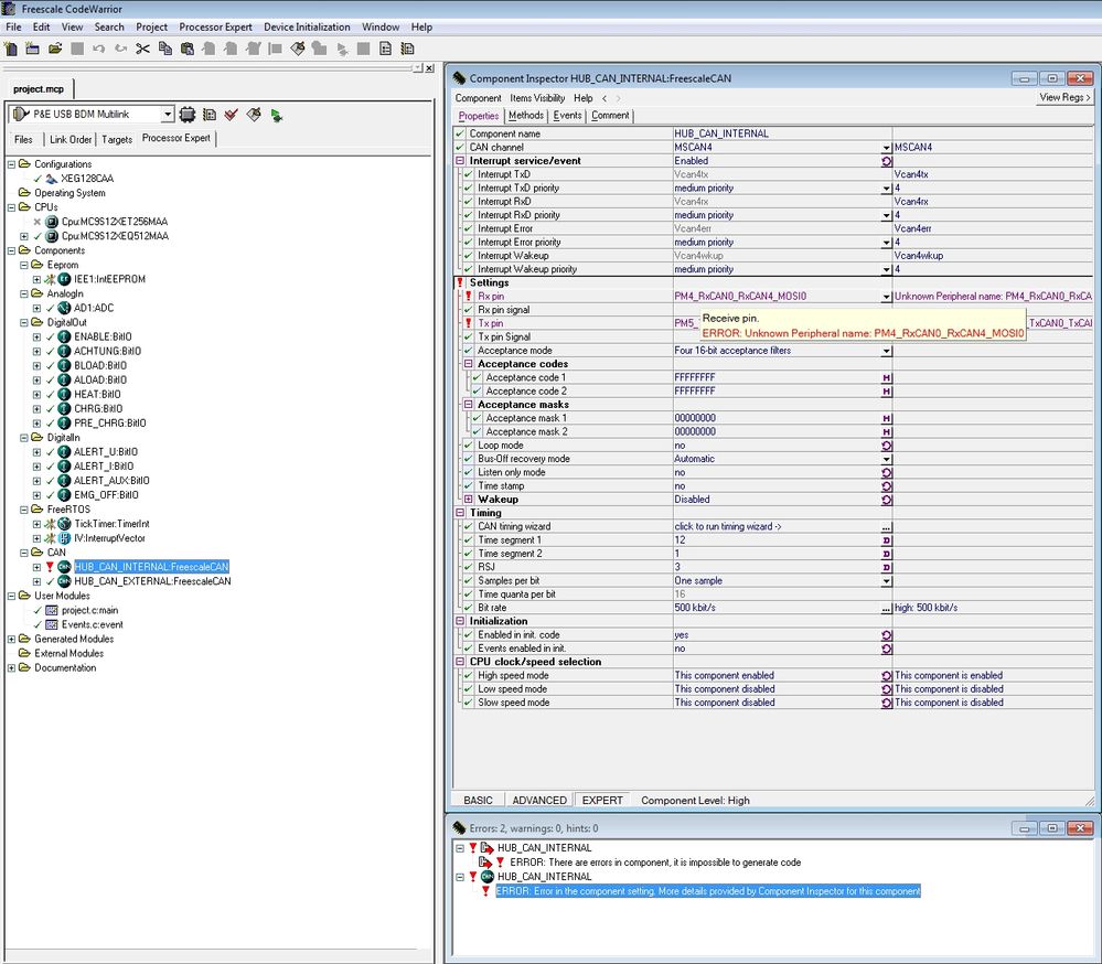

After adding a new component to our project - cpu S12XEQ512 and setting up its configuration the same way as we have in the S12XET256 the first compilation is not possible. We're getting an error about component setting regarding HUB_CAN_External module. Originally we set it to Pins PM4 and PM5 (the same as in 256 project). However the error in CodeWarrior says that the "Peripheral is unknown" and forces us to switch to the pins PM6 and PM7. After that the compilation works flowlessly but when we run the software with the debugger we are getting Illegal_BPs each time.
No one from our team checked this thing twice as we thought CodeWarrior should take care of such things, and when it says that the old configuration is not possible with the new Cpu then that's the way it is. Anyway, after the fist compilation we are able to manually change Can Pins back to the PM4 and PM5 and everything works perfectly.
I'm attaching some screens to depict the problem:
