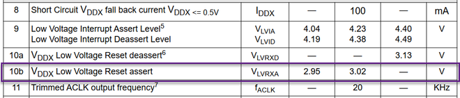

The Low-voltage reset asserts typically at 3.02V VDDX.
Can you monitor VDDX along with the Reset pin using an osciloscope? I assume the MCU is being periodically reset when you measure VDDX = 2.9V.
