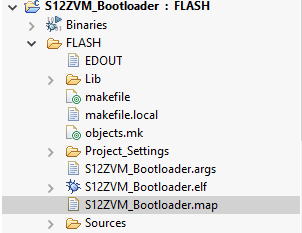

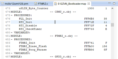

Where it is? Download example, and check.... for example AN4723 S12ZVM example...
Of course, the placement of the functions is defined in the prm file
and then functions are placed into this space in the C code
#pragma CODE_SEG SHADOW_ROM /* The following functions must be placed on the SHADOW section to be moved to RAM */

Flash driver, there is one rule valid for each device. The Flash memory block is not read-while-write. So, the code is not allowed to be executed out of the memory which is currently E/W. Because of this, usually the part of the flash driver which waits for command finished flag is located in another memory. It can be in EEPROM, RAM, …., any memory which is available but not in the same memory block which is currently processed E/W. This MCU, however, do not enables for this action to use EEPROM (older families of S12 devices yes, because of different memory structure)
