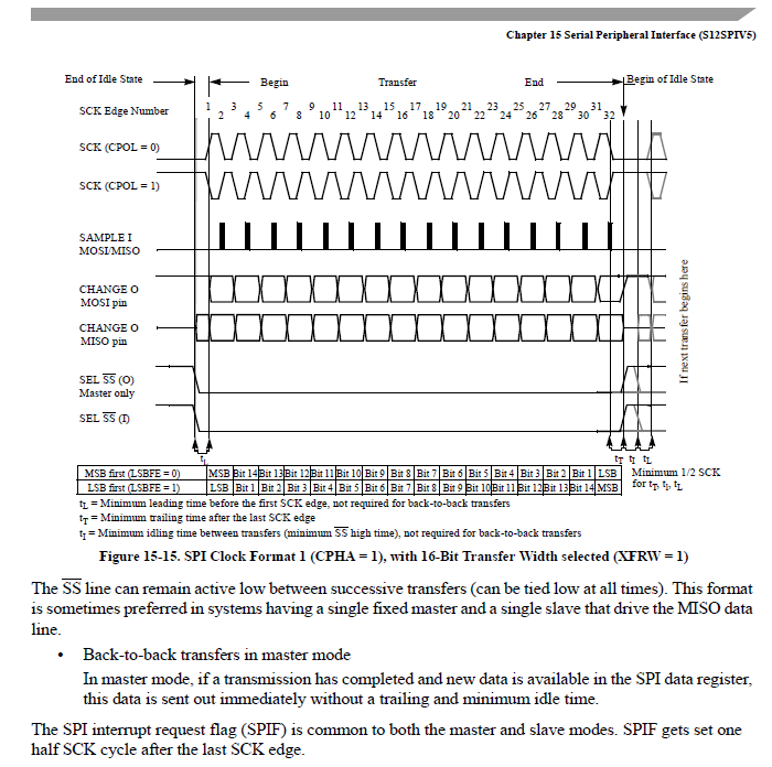

I want to spare a CS (SS) where my S12ZVC acts as a slave.
Configuration with 1 Master and 1 Slave.
According to Spec 15.4.3.3 CPHA = 1 Transfer Format it is possible, and I pull my Slave´s SS to ground.
"The SS line can remain active low between successive transfers (can be tied low at all times). This format
is sometimes preferred in systems having a single fixed master and a single slave that drive the MISO data
line.
• Back-to-back transfers in master mode
In master mode, if a transmission has completed and new data is available in the SPI data register,
this data is sent out immediately without a trailing and minimum idle time.
The SPI interrupt request flag (SPIF) is common to both the master and slave modes. SPIF gets set one
half SCK cycle after the last SCK edge."
Nevertheless, SPIF interrupt is not occuring. The interrupt SS1_Interrupt comes only once after boot and never again.
Why?
P.S. Pls see in the spec Figure 15-15. SPI Clock Format 1 (CPHA = 1), with 16-Bit Transfer Width selected (XFRW = 1)

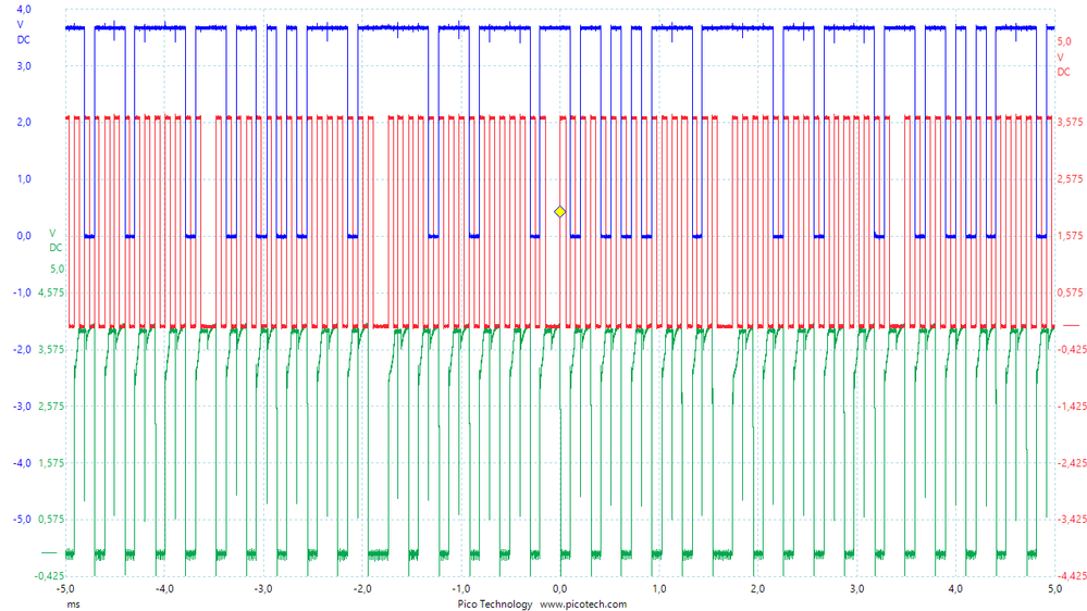

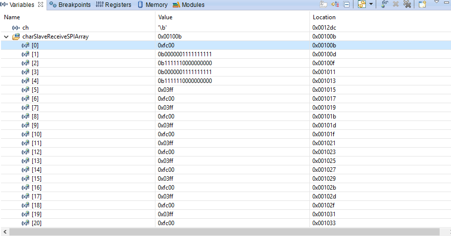

the SPI bits are not being synchronized properly on SLAVE side without SS.
With SS it is working perfect, but with SS grounded on SLAVE side (SS grounded from beginning of boot) bits are getting mixed up.
It seams like a sync problem.
Master toggles MOSI in red between:
SM1_TComData sendSPIChr1 = 0xFFFF;
SM1_TComData sendSPIChr2 = 0x0000;
Clock is Blue.
SS is green.
MISO is Orange.

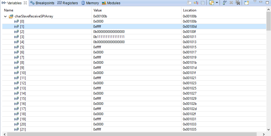

WITHOUT SS CONNECTED TO THE SLAVE:
   100 values stored in array:
WITH SS CONNECTED TO THE SLAVE:

Did you check with scope what happens on /SS during SPI setup. Isn't master booting up and driving /SS low later than slave initializes? If /SS is disconnected then what about toggling /SS on slave side once after SPI setup, perhaps enabling internal pull up on /SS before initializing SPI, and changing pull direction after SPI initialization?

/SS is optional on master (SSOE bit), you can't repurpose it for different function on slave! On beasts like iMX, where each pin has its own function select register, perhaps you could, but not on S12ZVC.
Even if you could detach /SS from slave, what about synchronization without SS? You can implement easily something like network SLIP protocol to synchronize at byte level start of the packet, resynchronize in case some byte can be lost. But what about 1st bit synchronization? You loose first edge and... If both slave and master are on the same board and are powered synchronously, then you could configure master and wait say 200ms, while slave powers up and enables SPI perhaps 100ms after power on. This would kind of provide 1st bit synchronization.. But you still would need to have some I'm alive and not silly checks on both master and slave. Once happens, disable master SPI activity say for 200ms, disable SPI on slave, use port interrupt to detect master is idle say > 100ms, then reenable SPI...

Now, if I understood your 2nd paragraph, your concern is regarding initial synchronization. Currently, I am testing this with 2 Hearst devel boards, so I can force SPI Slave to run first, then I turn on the SPI Master, therefore initial sync should not be a problem.
Nevertheless, SPI Slave is not receiving properly nor responding.

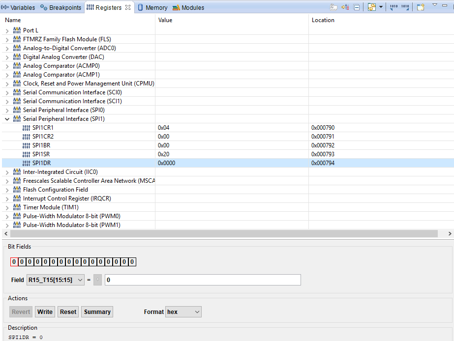

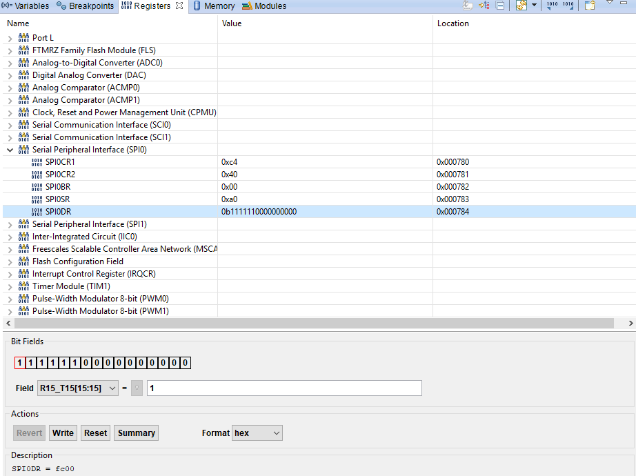

How does look you SPI setup code, as well interrupt handler regarding reading, writing data and flags clear? Did you try 8-bits mode?
Edward
5,654 Views
dordestojicevic
Haven´t tried 8 bit, but it should also work in 16 bit, according to spec.

dordestojicevic

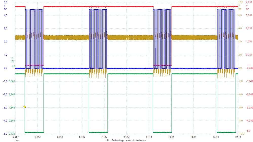

OK, I found out what is the problem :-)
SPI CLK line was broken. :-)
I am getting though response from the slave which is not very logical (see above) for the constant slave message:
0b0101010101010101
5,654 Views
dordestojicevic
P.S. I am measuring with an oscilloscope and messages from the master are fine.
Though, when I pull slave´s SS to ground, it´s MISO goes to unsteady -10mV, otherwise without pull of SS to ground it is on steady 1,18V.
