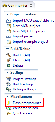

Please start Flash Programmer (Blue lightning icon)

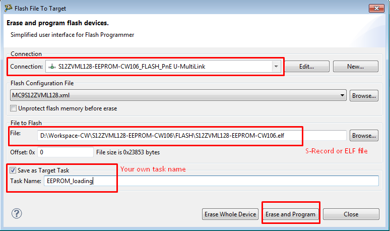

Please select already created Connection with Flash Configuration file and choose S-Record or ELF file as File to Flash. You may save this configuration as Target Task by adding your own task name and click on “Erase and Program” button:

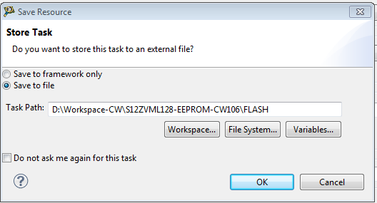

If you save this task, it will ask you whether you want to save this task only to the framework or also on your disk.
After that, it will start with Flash/EEPROM loading.

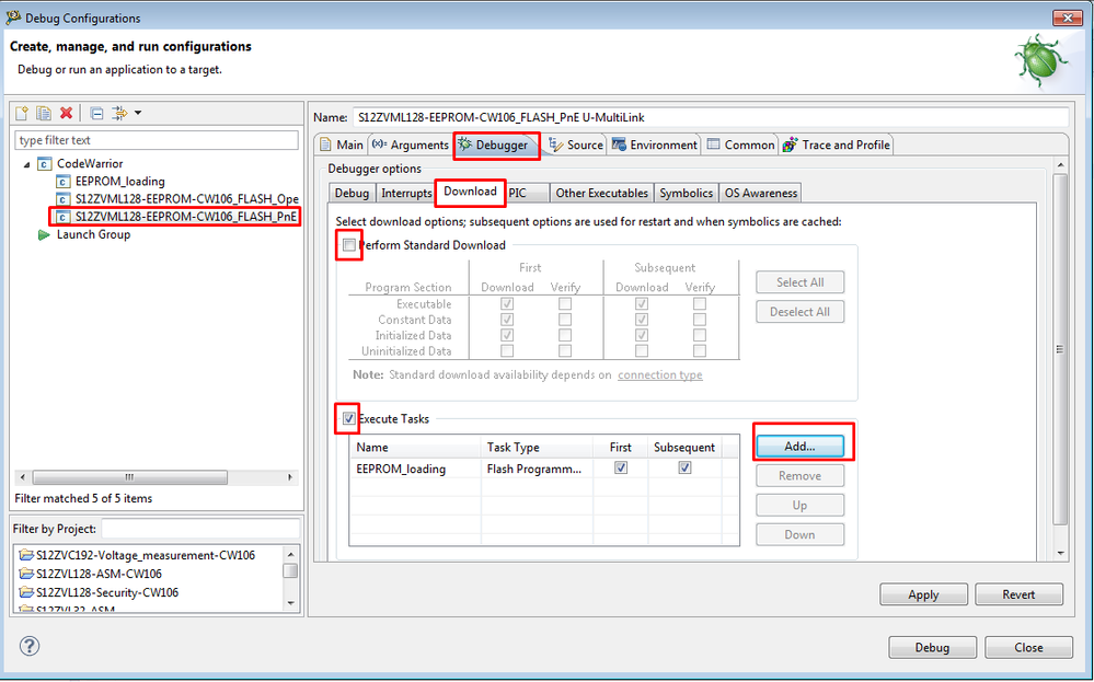

The currently executed Tasks may be configured in your debug configuration - go to Debugger tab and Download sub-tab.
There you may check out “Perform Standard Download” and check “Execute Tasks”.

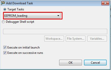

When you click on “Add …” button, you may add your target task.
With that configuration, you may load Flash/EEPROM data standard way – through Debug button and select whether you want to download Flash or EEPROM or both together.
