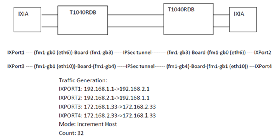

D. Assign interface IP addresses and routes according to setup.
  • Left DUT:
  • ifconfig fm1-gb0 172.18.18.10 netmask 255.255.0.0 up
  • ifconfig fm1-gb3 200.200.200.10/24 up
  • ifconfig fm1-gb1 172.20.20.10 netmask 255.255.0.0 up
  • ifconfig fm1-gb4 20.20.20.10/24 up
  • route add -net 192.168.1.0/24 gw 172.18.18.2
  • route add default gw 200.200.200.20
  • route add -net 172.168.1.0/24 gw 172.20.20.2
  • route add -net 172.168.2.0/24 gw 20.20.20.20
  • arp -s 172.18.18.2 00:00:00:00:00:01 (optional)
  • arp -s 172.20.20.2 00:00:00:00:00:02 (optional)
  • Right DUT:
  • ifconfig fm1-gb0 172.19.19.10 netmask 255.255.0.0 up
  • ifconfig fm1-gb3 200.200.200.20/24 up
  • ifconfig fm1-gb1 172.21.21.10 netmask 255.255.0.0 up
  • ifconfig fm1-gb4 20.20.20.20/24 up
  • route add -net 192.168.2.0/24 gw 172.19.19.2
  • route add default gw 200.200.200.10
  • route add -net 172.168.2.0/24 gw 172.21.21.2
  • route add -net 172.168.1.0/24 gw 20.20.20.10
  • arp -s 172.19.19.2 00:00:00:00:00:02 (optional)
  • arp -s 172.21.21.2 00:00:00:00:00:04 (optional)
E. Configure IPSec policies and SAs (attached below that needs to be downloaded to the box via tftp or sftp)

G. Configure IXIA/STC to generate the traffic with 128 flows.
H. Start the traffic from both end and verify all the flows are offloaded and packet is going through IPSec ASF.
