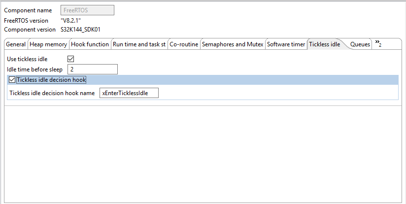

I try to generate tickless idle decision hook in the Processor Expert of NXP Design Studio, there is an option during the configuration:
Which generate:
configUSE_TICKLESS_IDLE_DECISION_HOOK 1 and
configUSE_TICKLESS_IDLE_DECISION_HOOK_NAME in the FreeRTOSConfig.h.

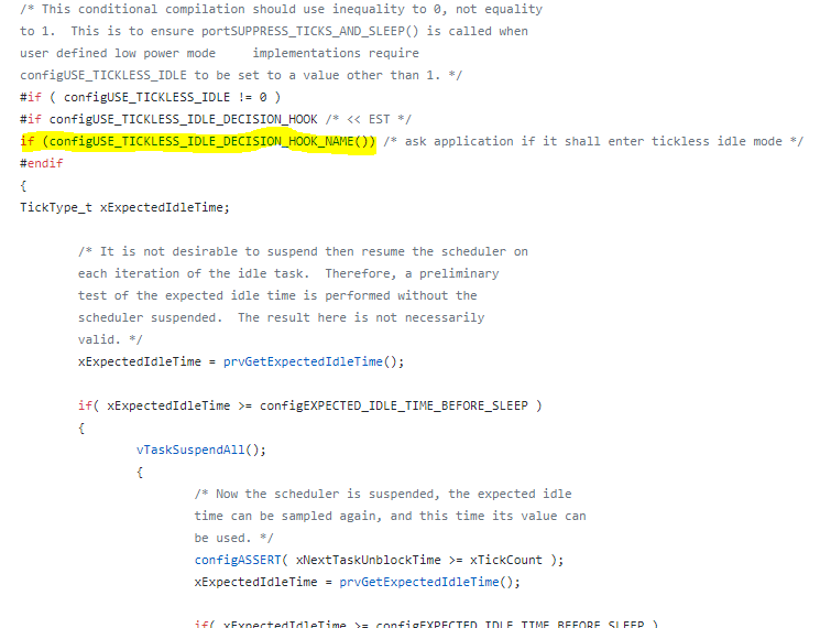

I have come across ports of FreeRTOS where the implemantation has been made in task.c (line 3336 & 3337)
I talked about marked line:

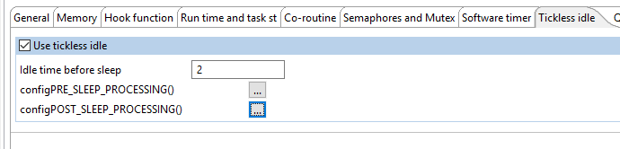

In my implementation of task.c I can't decide when we can't enter to idle mode, see below implementation :
I use new S32SDK_S32K1xx_RTM_3.0.0. but the same problem exist in BETA v2.9.2
Do You able to generate this code in your SDK or know what's the reason ? It's SDK or FreeRTOS fault ?

Hello Jan,
Seems that the snapshot included is from an earlier version of the S32 SDK. Both BETA 2.9.2 and RTM 3.0.0 include FreeRTOS v10.0.1, and the Processor Expert component has been updated to reflect the current configuration options:
The FreeRTOS configuration options configUSE_TICKLESS_IDLE_DECISION_HOOK and configUSE_TICKLESS_IDLE_DECISION_HOOK_NAME have been deprecated from FreeRTOS for this version.
If you are still seeing "V8.2.1" in either BETA 2.9.2 or RTM 3.0.0 there might be an issue in the project. Perhaps creating a new project with "New Project from Example" might help.
