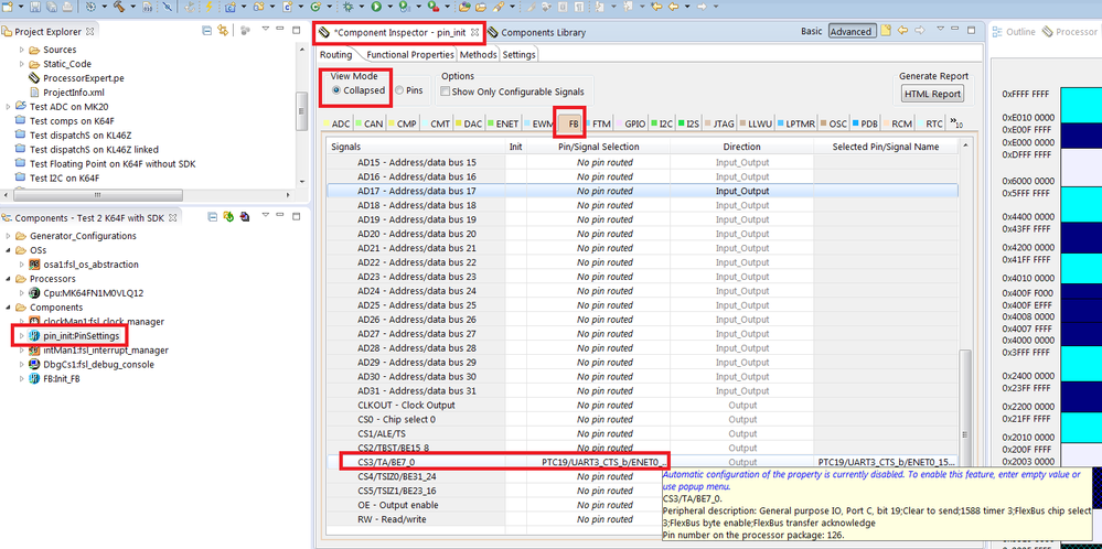

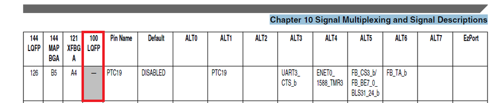

Which Kinetis derivative are you using in your application? Are you sure that you have selected the right package of the derivative? For example MK64FN1M0 derivative has several packages but the TA pin is not supported on MK64FN1M0VLL12 (100 pins package), see Chapter 10 Signal Multiplexing and Signal Descriptions in the reference manual:
When you want to configure routing of pins you can also use the PinSettings component. In the Component Inspector of the PinSettings components select the Collapsed View Mode and the FB tab to configure routing of FB pins. See the following screenshot.

I have the MK64FN1M0VLQ12 package selected (144 pin package). All the pins appear on the PinSettings as expected.
I have tried to set the pins in the PinsSettings as well. For the FB_TA_b pin, if I select it in both the Init_FB component and the PinSettings, Pex generates an error but it doesn’t care about the other two pins. Either way the pins are not setup in pin_mux.c or anywhere else.

I have checked the Init_FB on MK64FN1M0VLQ12 and I have reproduced the problem of the FB_TA pin routing. There are two alternative functions of this pin - FB_CS3_b/FB_BE7_0 and FB_TA that are selected by the MUX pins of the PORTC_PCR19 register but there is not support in the PinSettings for both alternate functions of this pin. I will report this issue to the Processor Expert development team.

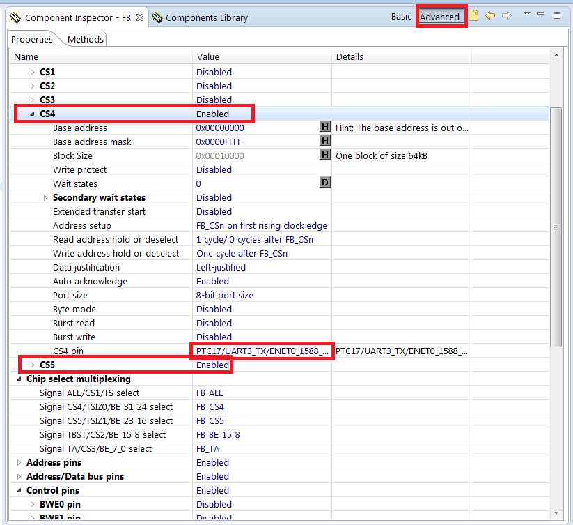

The CS4 and CS5 pins can be configured properly and the following code is generated in the init_fb_pins() funciton in the pin_mux.c program module:

I have configured (enabled) CS4 and CS5 pin functionality in the Chip Selects group of the Init_FB component, see below:

Thanks for looking at this. I think, with your help, I have the required settings for CS4/TSIZ0/BE32_24 and CS5/TSIZ1/BE23_16 now:
·        Select FB_BE_32_25 and FB_BE_23_16 in the Chip select multiplexing section,
·        Don’t select SIZ0 and SIZ1 pins in the Control pins section,
·        Select the CS4/TSIZ0/BE32_24 and CS5/TSIZ1/BE23_16 pin settings in pin_mux:PinSettings component.

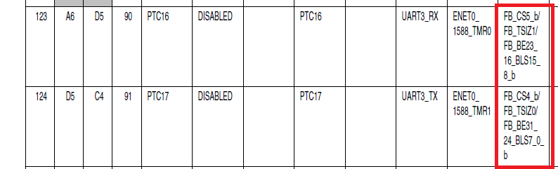

The PTC16 and PTC17 pins cumulate the functionality of CS, TSIZ and BE. When you use these pins as BE (FB_BE23_16 and FB_BE31_24) the CS4, CS5, TSIZ0 and TSIZ1 functionality cannot be used (there are not any other pins that can be used), see the reference manual.

As far as the BE signals go, I realise that functionality is exclusive and I am just using the pins for that function. My observation was simply that to enable the pins as BE I have to use the pin_mux:PinSettings component as well as the FB_Init settings, whereas the other FlexBus pins are configured for me in the FB_Init component so it just seems inconsistent.
